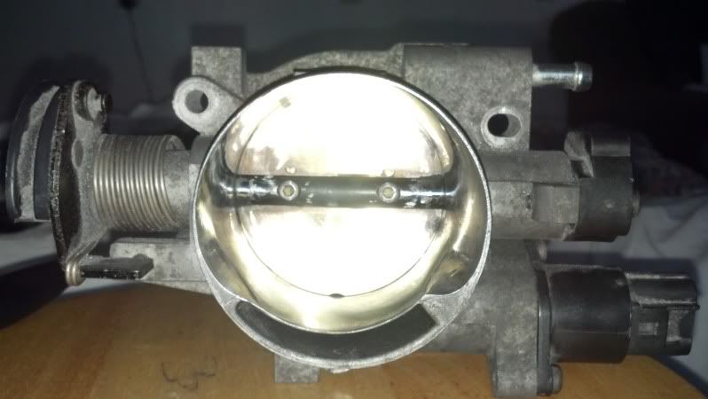

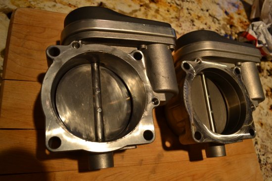

Ryan, please, could you send me a photo of these 4,7HO casting? Thanks a lot!
Изменено пользователем vadimnizh
Автомобиль: WJ 4.7 2002
Город: Vero Beach, Florida
This is a older 2001-2004 4.7 casting. The way it comes from Jeep there is a large lip around the inlet, i remove this for more flow and more taper.

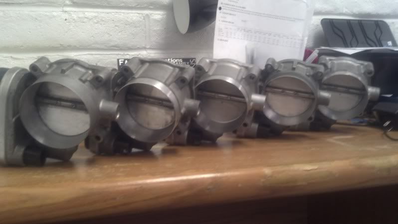

This is a bunch of 5.7s i did, some for WK1s, others for Dodge Rams.

Автомобиль: WK2 3.6 LIMITED
Many thanks of Rajn! You as pierce from an underside 4,7HO casting?
Forgive for my English, I use the translator!
This is not a problem, i understand that is hard to communicate because of the translation...
The underside looks the same as factory, just made larger in diameter and tapered in opposite direction so blade area is the smallest diameter in the casting. The inlet is the side that needs alot of work...
32
Many thanks, Rajn! Now I have understood all! Tomorrow I start alteration 4,7HO casting)))
