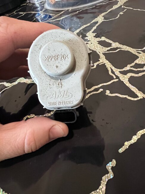

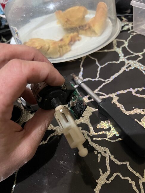

Появились эти ошибки хотя внешне никаких изменений в работе фар нет- светят как и раньше....стираю ошибки  они снова появляются ... может откалибровать фары?
1 105
Автомобиль: Liberty 2.0 CRD
RAM 2500 6.7 тоже дизель
HEADLAMP SWIVELING POSITION SENSOR - GENERAL ELECTRICAL FAILURE
Theory of Operation
Спойлер
The Left and Right Headlamp Swiveling Motors are used to control the horizontal movement of the Front Headlamps. The Adaptive Front Lighting System (AFLS) Module controls these motors via a LIN BUS circuit. The Headlamp Swiveling Motors are integrated into both the Left and Right Headlamp Housings. If a motor is defective, the entire assembly must be replaced.
  • When Monitored:
    With the ignition on, headlamps on.
  • Set Condition:
    The Adaptive Front Lighting System (AFLS) Module detects an internal failure in the Headlamp Swiveling Motor.
Possible Causes
HEADLAMP SWIVELING MOTOR
Diagnostic Test
CHECK FOR AN ACTIVE DIAGNOSTIC TROUBLE CODE (DTC)
1. Turn the ignition on.
2. With the scan tool, read DTCs.
Does the scan tool display this DTC as active?
Yes
  • Replace the Headlamp Assembly in accordance with the Service Information
No
  • Test complete, the condition or conditions that originally set this DTC are not present at this time. Using the wiring diagrams as a guide, check all related splices and connectors for signs of water intrusion, corrosion, pushed out or bent terminals, and correct pin tension
Короче,  дядя,  светит тебе замена двух фар. :to_keep_order:
